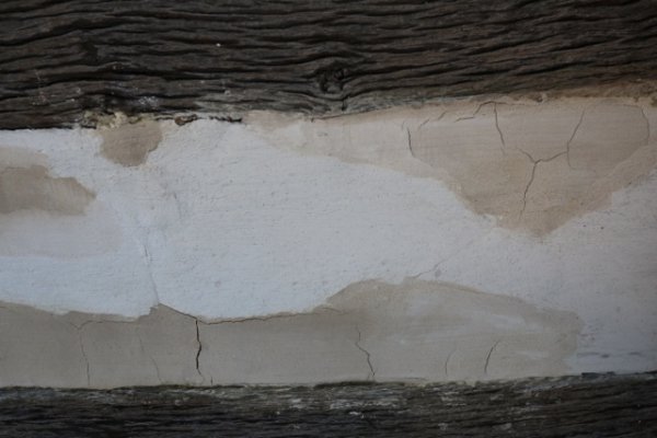

Any suggestions about how to avoid this sort of thing?
I used a 2:1 soft sand : lime putty mix to repair some holes and missing bits of render prior to painting. I misted the area before application and filled and smoothed a few cracks after a couple of hours before misting it again in the evening, but this morning it looked like this.
Some areas are about one inch thick so I'm wondering if I should have applied more than one layer?
It's not a big issue in this case because I can easily fill the cracks before painting so the end result should be ok, but I've got a few larger wall areas I was going tackle and am wondering how best to prevent cracking occuring in general.
