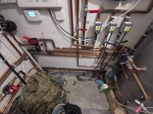

Are there any members with a log burner with integrated back boiler that could share a few details of their set up, connections and controls.
I've had a lot of help here, particularly Fernicarry, to get our system of thermal stores, underfloor heating, radiator zones and solar thermal installed and operational. There's just one more element to go - an Arada Stratford EB12 boiler stove which was purchased some time ago before these devices were phased out. I'm finally working on the room where the stove will be positioned and looking forward to seeing some heat from it soon!
I've attached a photo showing the room the radiator store is in (excuse the mess). The stove will be fitted on the other side of the wall shown in the photo with the majority of the pipework. It's on the same level so a pump will be needed. I've briefly looked at ladomat type pump arrangement but was advised it is overkill for a small boiler...
Any advice or suggestions would be very much appreciated. Thanks.
