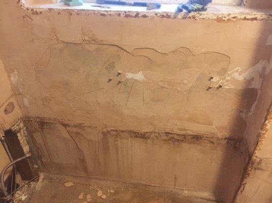

I bought a part lower ground floor flat in September last year, and I've been having some problems with damp/mould/condensation. The worst affected room is my bathroom. I decided to take out the bath and remove the tiles from the walls to try and see what was going on. Here's a picture of how the bath space is looking now. A couple of things to mention:
- Previously, there was a piece of wood attached to the wall that was tiled to make a straight edge for the bath. This was fitted where the darker brown line is.
- The screws in a triangular formation are from a grab bar I removed when taking off the tiles.
- Some of the plaster came off when I was removing the tiles and other sections I have pulled off because it was wet and crumbling and hanging on by a thread.
- The particleboard sub-floor was wet through when I first took the bath out, which I think was, at least in part, due to defective silicone that was allowing water to run between the bath and the wall and onto the floor every time we had a shower.
- I've had a dehumidifer running 24/7 in this room for the past 3 weeks. When it's on, the humidity gets down to 40-45% (although it's got as low as 35%), but starts climbing again if I turn it off.

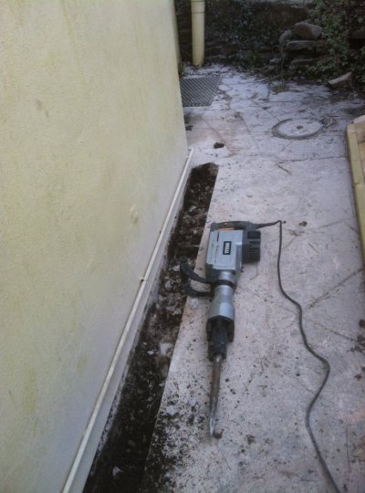

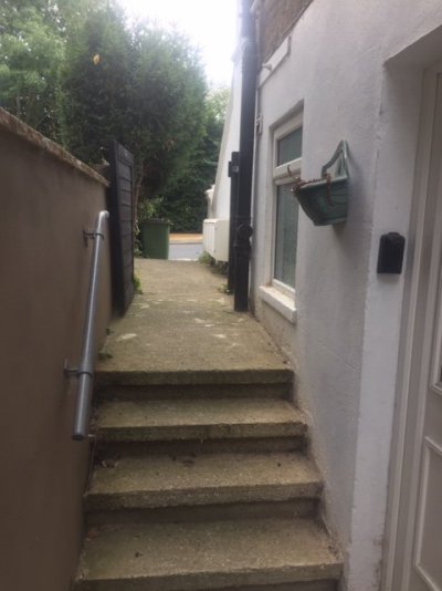

This is what that same wall looks like externally.
So obviously the ground level is quite a lot higher than the indoor floor level, the wall is rendered and painted and there's a pipe disappearing into the concrete. There are what looks like DPC injection marks under the window and then above each of the steps leading down, so I can't be the first person that's experienced damp here (although I would like to try and rectify it the right way!).
The building is Victorian with solid brickwork and suspended floors.
I suppose my question is: where would you start? Does it look like the wall has been rendered internally and should I do anything about that? Should I get a drain survey to see if that could be causing an issue? I know lowering ground levels is often advised, but would that even be possible with the steps (which are a RoW for the upstairs flats to the garden at the rear, so anything I do, I'd need to get permission for - and be convincing it was necessary!)?
All thoughts appreciated!
