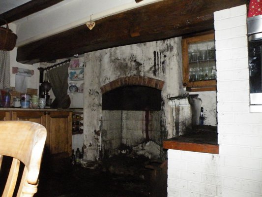

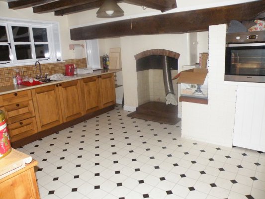

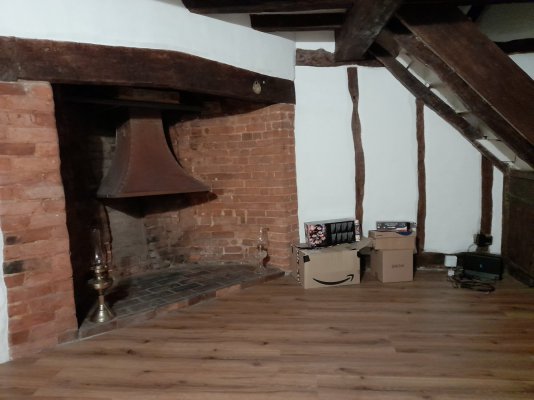

yes but havent lit in years as been semi-abandoned for 40 yearsHave you got an open fire below?

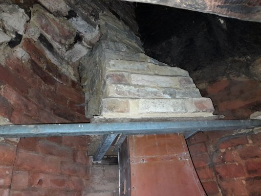

im gessing steelIMO - If that is not unstable right now it will be in the not too distant future.

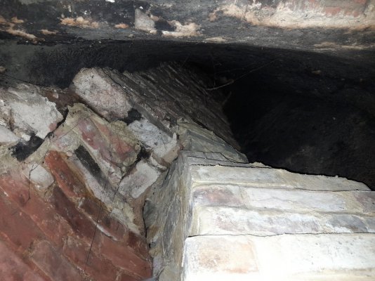

Is the square plate under that brickwork made of steel? If not, what?
All that weight is ultimately carried on the galvanised box steel frame which has been embedded in the brickwork and sealed in place with mortar. The cut ends of the steel will be exposed to corrosive elements in the mortar and will ultimately cause it to fail leading to a possible collapse of the brick flue above and perhaps elements of the outer wall of the property. Its definitely worth correcting sooner rather than later.
You might be able to build up a brick fireback from the bottom up to the flue above, removing the bodged brickwork.View attachment 14902
Do a quick magnet test. TBH I would be surprised if it wasn’t steel, but you never know with bizarre previous works.im gessing steel
