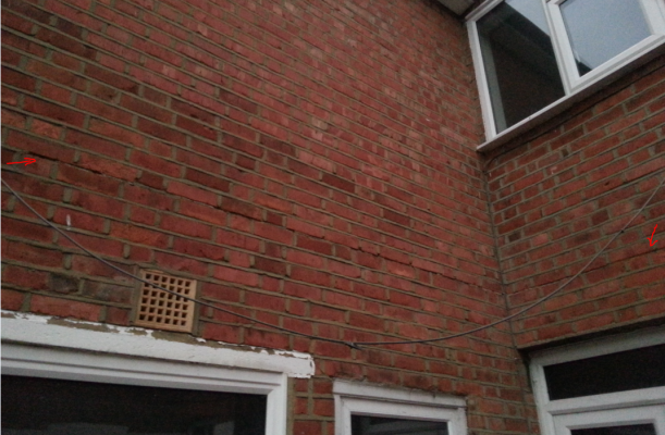

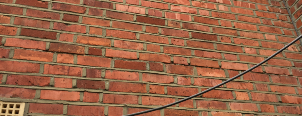

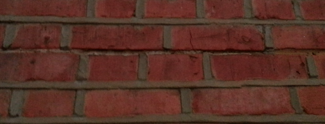

We have lived in our 1890's solid wall red brick house for just over a year, we love it and so for thankfully we don't have any damp problems within the house. However, the walls outside are suffering a bit from bricks spalling and I want to get bricks turned or replaced to rectify this. I have had a number of people (all 'lime/heritage experts') look at the house and all have said that part of the problem with the bricks is that at some time in the past the walls have been repointed with cement based mortar. All have recommended raking out and replacing with a lime based mortar - this is the only consistent advice as beyond the basics the details of how, when and using exactly what mortar vary quite considerably. Having researched a lot in recent weeks and months lime pointing does seem the way to go, however I have also read a number of horror stories about house owners having considerable damaging water ingress problems after having walls repointed in lime. Admittedly, most of these do seem to be in recent times when rainfall in the UK has been prolonged and persistent. Obviously I don't want to spend a considerable amount of money to rectify one problem and create possibly a worse one. I have no way of easily knowing what plaster, mortar etc has been used over the years on the inside. Grateful for any advice and words of wisdom and whether being a brick property is less of a worry than if built in stone etc.
