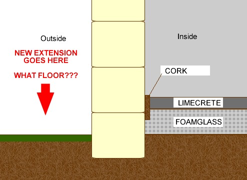

Hi
I've posted this on a facebook group too.
I'm having an extension built (the 'outside' part) up to what was an external wall...what flooring set up is acceptable that wont push damp into walls? Here's what I'm doing inside currently but there will be a new part outside ultimately...just wondering what is best thing to do.
EDIT: I'm not asking how to drain the outside - I would like to know what flooring would suit an extension here - given the regulations about DPCs etc...
