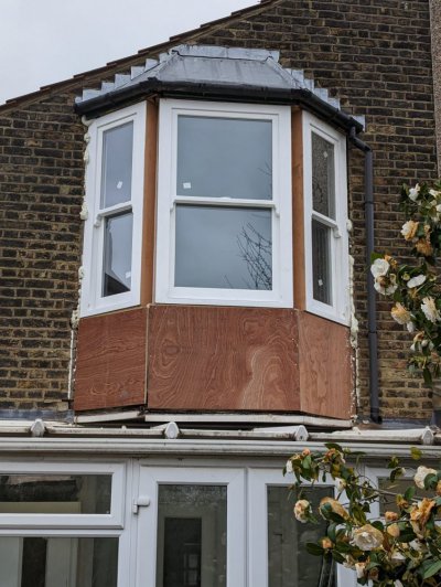

I've attached some pictures that show the whole bay for context, and then some close-ups that show the area where the water ingress is. Here are my own notes/observations based on what I can see, I have no idea if these are legitimate concerns or not:

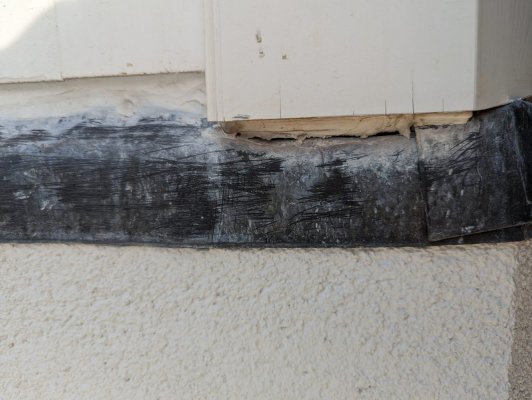

- The exterior of the bay has no sill to aid in water run-off, it looks like the windows are just sat directly on the bay and then have had some lead flashing added (pics 1+2)
- There is missing sealant where the bottom of the window meets the lead flashing (pic 4) (Note: I have since added sealant to this in an attempt to fix the water ingress, and it seems to have worked so far)

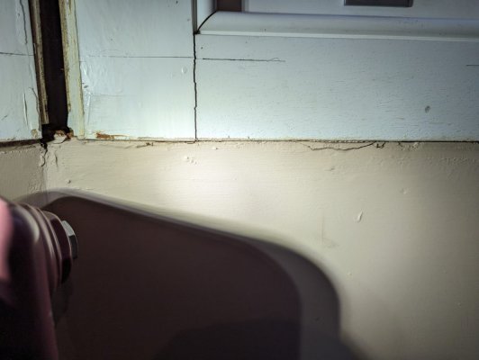

- There are gaps in the joins between the side jamb and the bottom rail of the window (pic 3 and 4). I don't think these were present prior to being installed and I don't know if they're normal movement of the wood or an issue.
