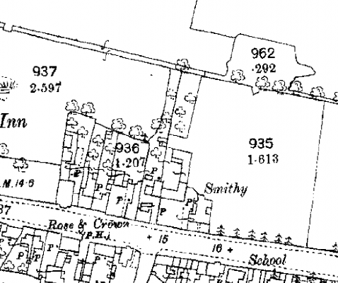

Delta said:Here is an extract from a 1888 map, scale 1:2,500. It conveniently shows my house, the Smithy, so I want to try and find out more. What do the number pairs mean, and where can I get more info?
935
1-613
The second number may not be a decimal. My deeds include a local document showing the area in "a, r, p", which are acres, roods* and (square) perches/poles, where there are 4 roods to an acre and 40 poles to a rood. (See http://gwydir.demon.co.uk/jo/units/area.htm which looks authoritative)Gareth Hughes said:The top number is the Field Parcel Number, and the bottom number is the area in acres.
In one student job, we had to be able to roughly estimate crop acreages. I would pace the field (my pace is roughly a metre), calculate in square metres, adjust this to hectares and then convert to acres. My boss would pace the field, calculate up from feet through yards to chains (22 yards) to acres (10 square chains). He reckoned his way was simpler!MatthewC said:The second number may not be a decimal. My deeds include a local document showing the area in "a, r, p", which are acres, roods* and (square) perches/poles, where there are 4 roods to an acre and 40 poles to a rood. (See http://gwydir.demon.co.uk/jo/units/area.htm which looks authoritative)

* not "rods" which are the same as poles and perches
