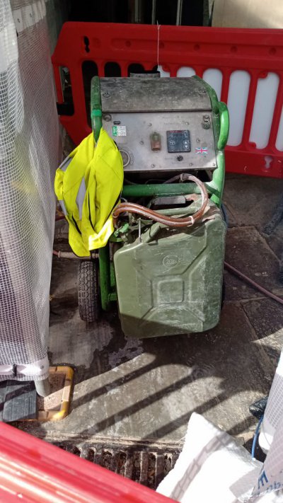

Remarkably, and sensibly, we’ve got the go ahead from our CO to rid our timber frame inside and out, and brick infill panels, of the suffocating black and white muck painted on in the 70s… I had a great experience Heritage operator lined up, who sadly can’t now take on the job. So, it’s alway worth an ask on here …
- does anyone have any good recommendations in the SW for experienced, heritage operators who use Doff/Thermatec/Torc systems on old properties - success is all down to the operator and their skill/experience. It’s never as simple as ‘shot blasting is damaging, soda is not, how about crushed almond shells…’
- internally, we have too much house and too much complexity obscuring the frame for someone to come in and clean the timber in one go, plus we have now moved in, so I’m considering purchasing kit so I can do it myself slowly, as and when we get to each room…any one got personal experience of doing this and where you got kit from? There’s a large amount of more important timber I will do manually / chemically, but too much to do the whole house this way.
Cheers all
