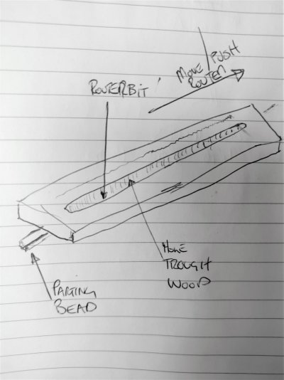

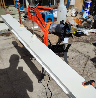

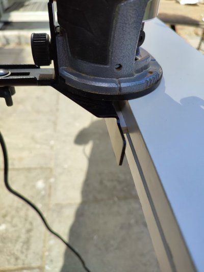

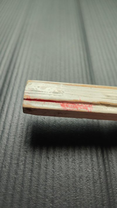

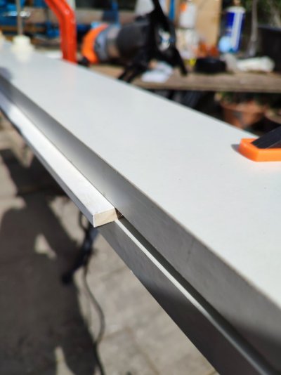

PPS: Theres also a 5 mm 'bubble' of Aquaseal weather strip , that neatly slides into a grooved plastic carrier, that's routed into the top of the top sash to seal against the top of the box
