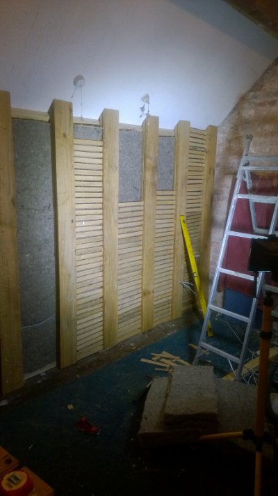

What materials would be nice for stud walls? I need to build one as a new inner part of an exterior wall (see previous posts about timber frame completely eaten by a big fat beetle).
But I just don't like plasterboard. There is no plasterboard in the house where you can't tell is plasterboard. Cracks along the joins, soft and hollow etc.
My preference would be to use lath and lime plaster on the inside, but the lath alone was going to cost £180, and the equivalent area of plasterboard was £36. An alternative might be to use wood wool board in place of plasterboard and treat it like a solid wall when plastering.
