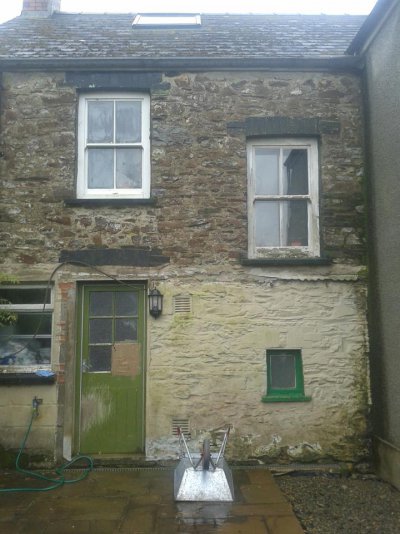

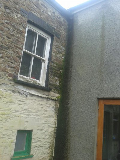

The painted section at the back of the house, where your leaking gutter is, must have had a lean to of some sort and that is why it is painted and lead flashing poking randomly out of the wall. I bet water is getting in where the lead is and also off the gutter which has probably been botched at the same time as extension built and lean to removed.
