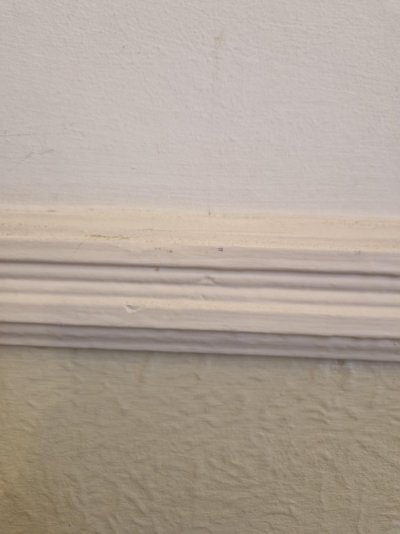

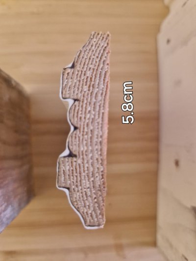

You'd make it up out of smaller sections, bit of a faff, but then you don't need much of it. The reeding and rectangles look like they could be made up from cut down parting bead. The outer section looks it could be made with one of the bits commonly found in cheap router bit sets. The Cheshire Mouldings rack in your local DIY store is the place to start.
Have you any 'traditional' joiner firms in your area? Then ones I'm using for my windows are happy to machine match skirts and architrave I throw at them at a reasonable cost. Might be worth a try (they obviously have all the requisite machinery...)Thank you. I will see what I can do. It's sometimes this restoration is a painful business trying to justify the costs. I have just removed an awful 1980's fire surround to discover the lovely original it was hiding, but they cut out about 6inches of the original skirting to make the surround fit. So now I have a gap I need to fill. I can't believe I am the only person locally to replicate their wood work, so frustrating not to be able to find these profiles.
I think you could replicate that with multiple passes of a router. But unless you already have the kit and the right sized cutters then cost-wise it would work out even more expensive that having a joinery shop do it.
Is the extra section to extend an existing piece? A join will look quite obvious due to the thick layers of paint on the existing pieces. Maybe move a longer piece from elsewhere in the room or another room and get a replacement for that made up?
Two router cutters would do it. A roman ogee, and a sunken bead. £40-60 each if you go for Trend or Orange. £10 each if you use cheap Chinese bits. Regardless of where the cutters are sources, the bead cutter would probably need grinding back on the sides.I think you could replicate that with multiple passes of a router. But unless you already have the kit and the right sized cutters then cost-wise it would work out even more expensive that having a joinery shop do it.
