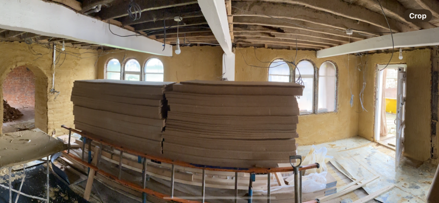

I have a question regarding use of wood wool boards on an external facing brick wall. This wall originally had laths fixed to battens that were fixed directly to the wall. Unfortunately, the internal plaster had to come down - partly because it was in terrible condition having been patched in various places with cement, gypsum plaster, plasterboard and any other poor intervention they could think of over the past 60 years. But also we needed to get a look at the wall behind it for the above mentioned structural surprises.
My question is whether you think it is a good idea to recreate the lath and plaster work using wood wool boards on the wall with the window? We have a bunch of them and so I thought that I could fix battens to the brick wall to create an air gap and then fix the boards to the battens (or rather, through the battens into the wall). The wall could then be plastered in lime as before. Any thoughts on whether this is a sound idea (or not) would be most welcome. What I could use to fix the battens and the boards to the brick wall or if there is a better way of going about this?
In the attached photo of Mrs jsmac having a rest after scutching off the gypsum plaster repairs off the wall next to the window (this will be plastered directly onto the brick in lime) you can see that there is a timber plate that runs above the window. Between the plate and the top of the window box is a several inch gap that was previously covered with lath and plaster that I'm hoping to fill with the wood wool board. Does this make sense? I can see why with this gap above the window that they used laths on this wall rather than plastering directly onto the brick.
