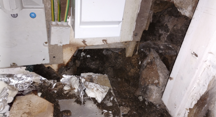

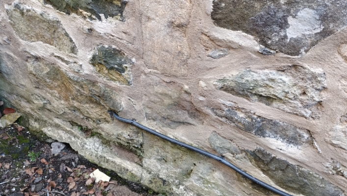

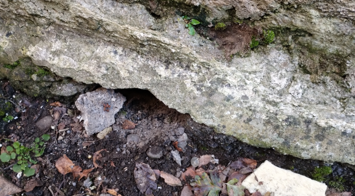

I have a long standing damp problem in a small room. It has been complicated by multiple contributing factors which I have now fixed (rotten joists, poor void ventilation etc) but there is one section on an internal wall that was baffling me. Poking around outside thinking that it was something to do with the vent I noticed that was very easily able to poke a hole with my fingers under the footings and within a few minutes nearly my whole hand was under. The ground level at this point is very close to the floor level inside, and the other side of this hole is an Edinburgh cupboard/meter cupboard which has always been damp at the base, but also the internal wall which has dampness at the base. So, my new theory (i've had a few before this one) is that water might be running under the wall here and possibly even into the cavity of the internal wall, causing all of the damp in this corner.
The question now is what to do about it. Obviously I have to fill the hole, but I feel like I have to do something more with this section and somehow shed the water away from the base of the wall. The footings are clearly already very shallow here as the front of the house appears to have been lowered in Victorian times and I will need to be careful not to disturb them any further. I am thinking maybe trying to clean away the dirt as much as possible and that cement/concrete rather than lime might be better here, to make a kind of protruding ramp at the base of the wall, to try and push any rainwater away from the base of the wall.
