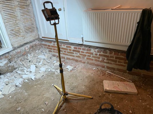

We are removing all the poorly laid concrete floors, letting footings dry out and replacing with limecrete (with foam glass).

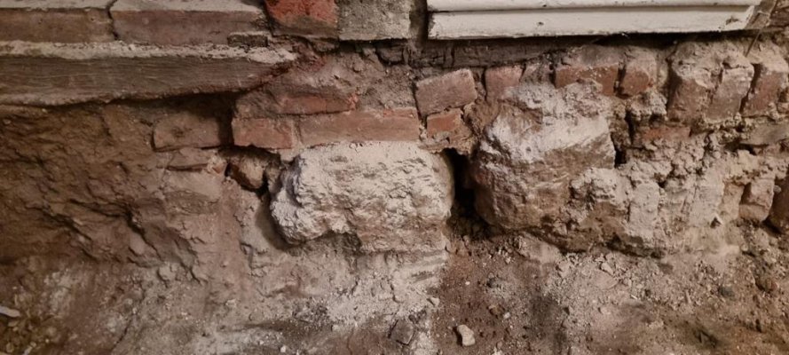

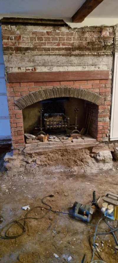

On doing so we've uncovered some questionable footings under a chimney, see attached pics. I am obviously worried about disturbing something that's been there for hundreds of years but my builder is telling me we need to remove the boulders and rebuild footing, going deeper to more solid ground as they are effectively sitting on mud.
Generally the builder has been really impressed with the footings, they are couple of feet deep and he said that's unusual for this type of building. See attached pics.
Just wondering if anyone had a similar experience or has any advice?
