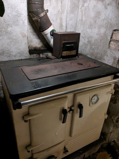

I've found that our stove is often a bit reluctant to start a syyphonic circulation, which is why I added the circulation pump. I sometimes find that the stove itself gets very hot, but there are bumping and bubbling noises from inside the boiler, as if the water is boiling but champing at the bit to get out. That's when I switch the pump on, and in seconds the noise ceases and all three radiators are very hot. It can then support the circulation unaided, but it works much better with the pump.
I suspect that a thermosyphon works best in the traditional way with the stove downstairs running a towel rail in the bathroom immediately above, together with heating the hot water in the airing cupboard in the same room. It doesn't seem very eager to circulate if there are horizontal runs.
I wonder also if the pipe diameter is important. Ours uses 28mm copper pipes, which I read was the minimum for an efficient circulation, but I remember that the pipes in the house where I grew up were cast iron about 2" in diameter. That included the single additional radiator in the room adjoining the kitchen.
A man at the local stove installers said that for efficient running the fuel should be up to the level of the sill with burning logs or coal, and the unburnt then piled on top. They don't run very well with only two logs.
