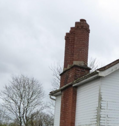

Since this photo, all the external pvc cladding has been taken off to hopefully allow the property to dry out. At some point we will take the render off and see what the brick is like underneath.

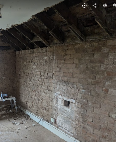

Photo showing the chimney stack from the inside. Room, including ceiling, fully stripped after this photo.
