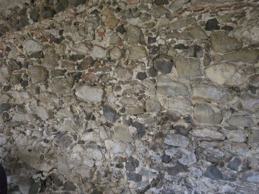

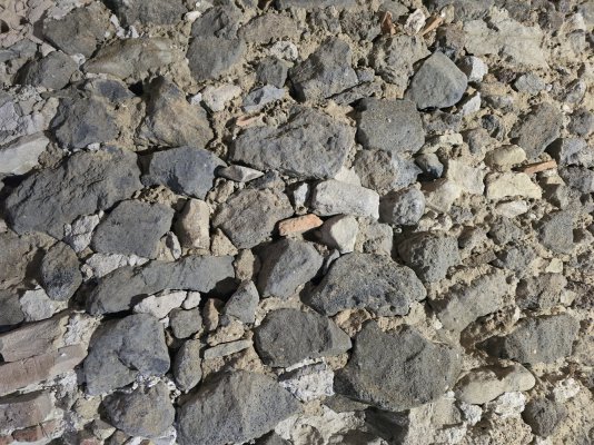

Hello all, this is my second post. I am slowly slowly renovating a house dated around 1765. I have experimented with lime rendering a old rubble stone wall based on the excellent advice received in this forum, and really happy with the result. I am moving onto another room, and here after removing the modern plaster and sandblasting, the underlying metre thick wall is still random rubble stone and lime mortar, but its very crumbly. Normally I would rake out loose material, before making patch repairs, repointing where needed and then applying the lime render by hurling. My dilemma here, is after testing the raking out process, I am finding that the more I try to rake out, the more stones and mortar become loose. My thought is to really just try and remove very obviously loose material, raking out in more of an archeological dig style, patch repair holes and gaps, then render anyway. My thinking is that if the stones are a bit loose now, applying a lime render is not going to make them any looser. The only alternative, is to be more bold and rake out hoping we get to a more solid area, I am not keen on that since its a bit of a gamble. But I am not sure? Does anyone have any experience or advice. Pics below. Many thanks!
