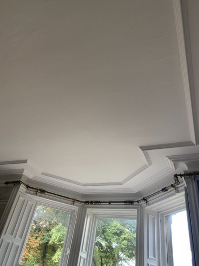

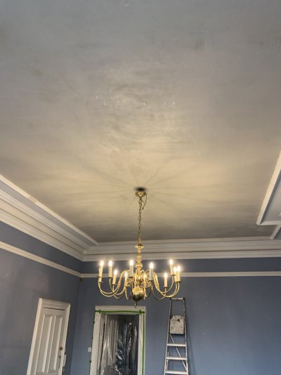

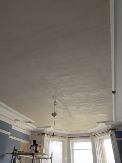

That looks amazing, full compliments to the plasterer! Best of luck for the final coat.View attachment 10173

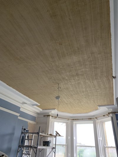

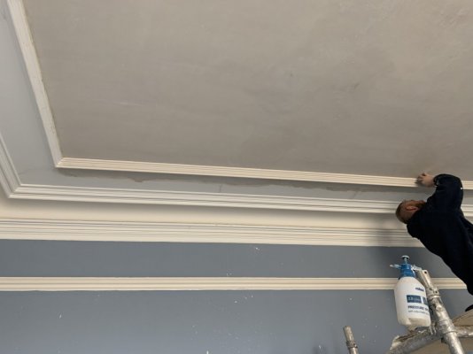

3rd and final coat going up today. Plasterer has used best of lime ready mixed product throughout and advised that it should be fine to paint after 4 weeks provided a very breathable paint is used.
I have read a lot of people on here saying to wait 3-6 months or 1 week per mm (there’s about 15mm here). Aparently best of lime product cures faster and I suspect it helps being a ceiling in that it can breath 2 directions (unlike solid walls which will mainly breath into your room).
Anyone agree that I should be fine to go ahead after a few weeks.. also was planning on F&B estate emulsion with an SD value of 0.010 however I have seen people recommend their casein distemper with an SD value of 0.008. The improved breathability seems minimal, is it really worth it?

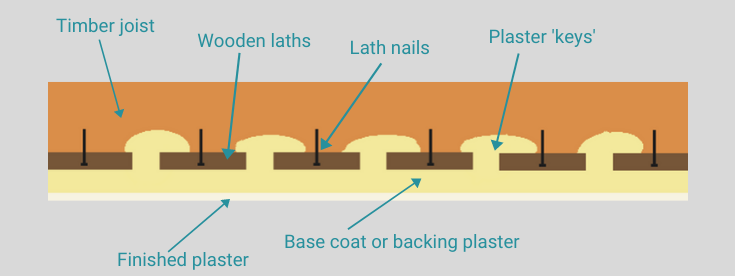

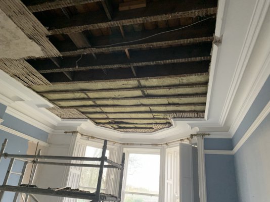

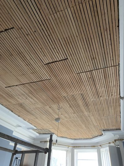

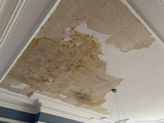

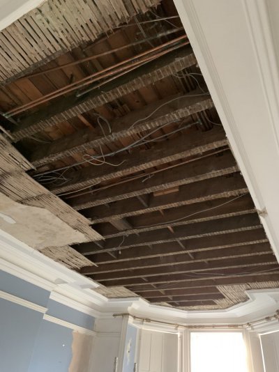

People plasterboard over lath & plaster ceilings all the time, it should be fine as long as the joists can take the extra weight. A perfectionist might prefer to remove the remaining lath & plaster before applying the plaster board but its a dirty job and you lose the excellent sound proofing of the old lath & plaster.@MatthewC thanks for this. The two rooms are an upstairs bedroom and the sitting room below it. My preferred option is for the reinstatement of original lath & plaster ceilings and/or just repair the damaged bits if possible. Original fabric of house and in keeping etc,
However, If the insurers refuse to go down that route because of betterment etc , ithen it is a case of remove existing ceilings and replace with plasterboard vs keep damaged original ceiling and stick up plasterboard underneath it. It seems you are recommending the latter option? With the sitting room ceiling could that "space" between the plasterboard and the old ceiling be a nursery for mould and rot?
