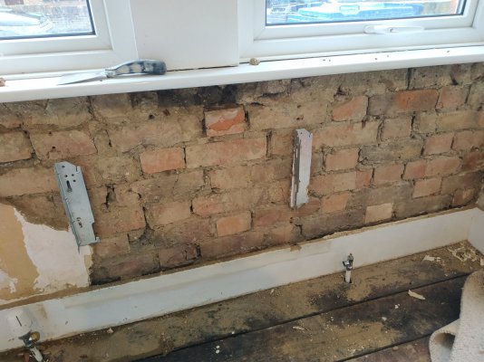

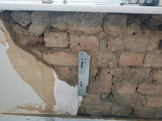

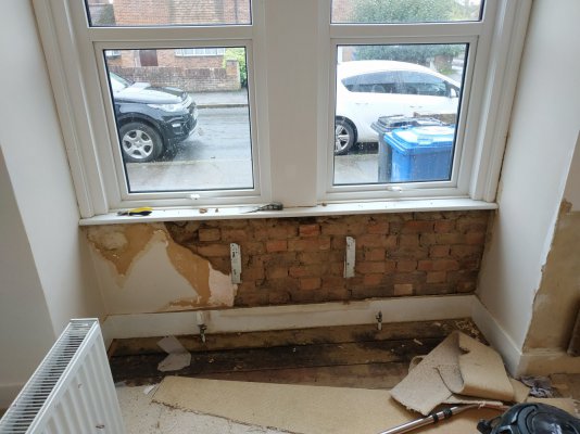

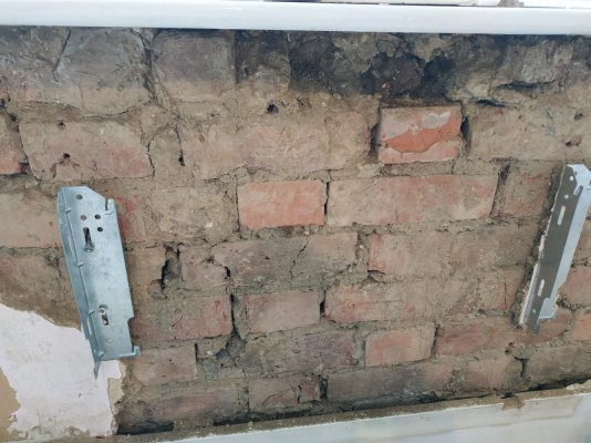

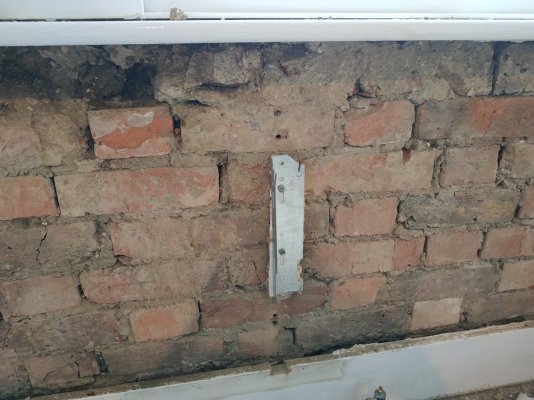

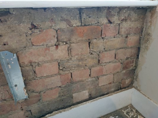

we have a small Victorian terrace.
The lime plaster behind the radiator in the front room had blown so it was removed.
There's a little lime mortar missing as shown in the photos.
Should i just fill the gaps with nhl3.5 lime mortar or should the old mortar be completely removed first?
Do i have to wait 90 days for it to dry before replastering with lime plaster or can that be done straight away? (does the answer differ depending on the answer to the previous question?).
Also, i'm a bit concerned about rehanging the radiator.
Is it ok to put normal cement mortar on the area where the radiator brackets screws are (for strength)?
Thanks
