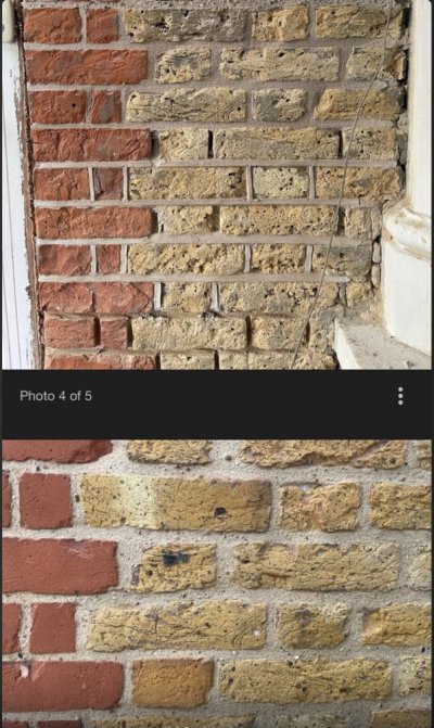

Hi all - I need to have non-breathable paint removed from my Victorian terrace and cement mortar removed to be repointed with lime. Honestly trying to find someone that I trust fully understands what’s needed and doesn’t just want to make the house ‘look nice’ is difficult. The only real option seems to be engaging a listed building specialist who will work mostly by hand but you’re looking at 4x the cost of some already very expensive quotes.
Anyway, there’s a restoration company that’s been around for 20 odd years that charges a premium, has nothing but 5 star ratings, was recommended by a neighbour - but one google review in praise of them clearly states they sanded down some bricks (before and after photos below). Every company of this type seems to be at it; from what I understand it ruins the bricks, so my question is, is everyone going to end up having to rebuild the front of their houses in London in 5 years because these restoration specialists are going round sanding bricks? Should I steer clear?
