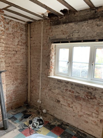

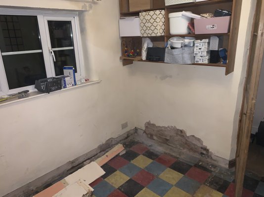

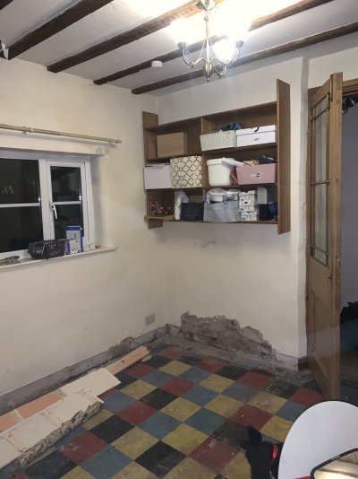

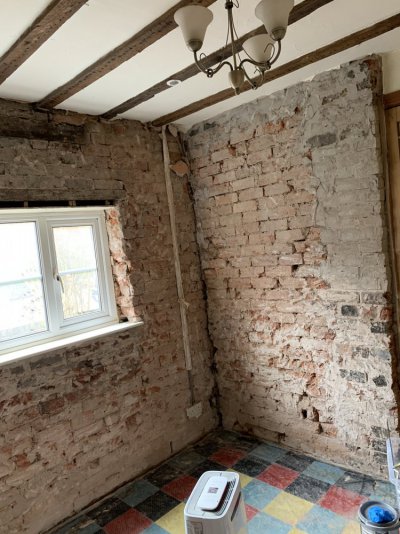

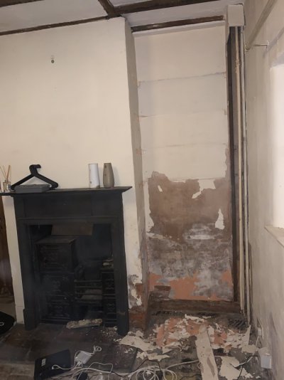

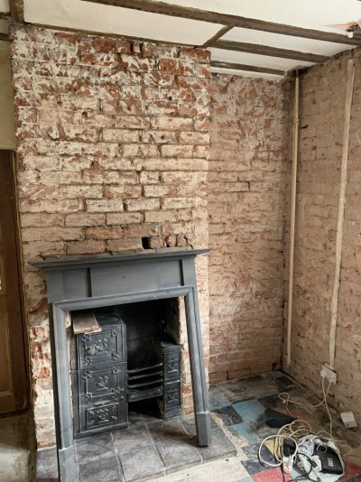

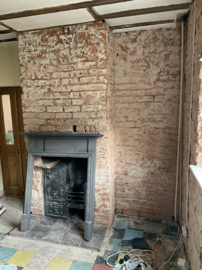

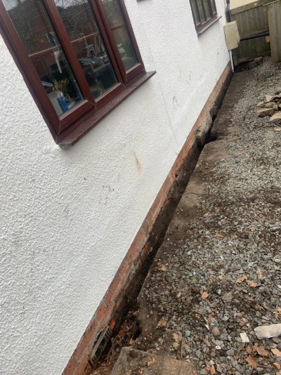

Current progress on rectifying the damp
Issue in this snug. We have removed the layers of plaster that’s been added over the years to allow the bricks to breathe again. Plan is to build a stud wall to allow a gap between the bricks to breathe to prevent the issue reoccurring. We have also dug out the old drain in front of the house and removed the roots that had found their way into the room. Next phase is to finish the outside drain and start the stud work.
