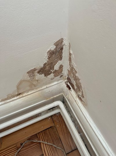

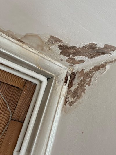

Source could be a number of things, the simple 'rising damp' touted by the sellers of waterproofing treatments and injected DPC is probably last on the list...
Is the ground level outside higher than the inside?
Is the outside wall cement redered or coated in a modern paint?
Are there any gutter or external drainage issues?
If you have a suspended floor, is it ventilated?
Any potential leaks from internal plumbing?
Is it a particularly cold corner?
The water has to come from somewhere, spontaneously rising up from the ground in one corner is possible but there's many more likely reasons (which can be addressed once identified)
We could do with a bit more info about the property. For example, is it a solid brick or cavity wall. How old is the house. Is the wall outside rendered, or face brickwork. Are external ground levels higher than the DPC. Was there any furniture against that wall?
Hi, I would check the damage to the skirting board, if it minimal, then it could be condensation, if not minimal damage then remove the skirting to see if the plaster touches the floor. Is there a DPC and or DPM ?
Hi, the location of the pipes don't really matter, and It's a bit dark for gypsum plaster, unless it's actually quite damp when the photo was taken, could be cement based render, which in turn could be trapping moisture or helping unwanted condensation issues.
