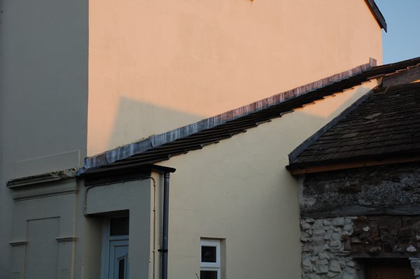

This pic was taken BEFORE any work was done. This side of the house is exposed to the wind and rain of which we have a lot!

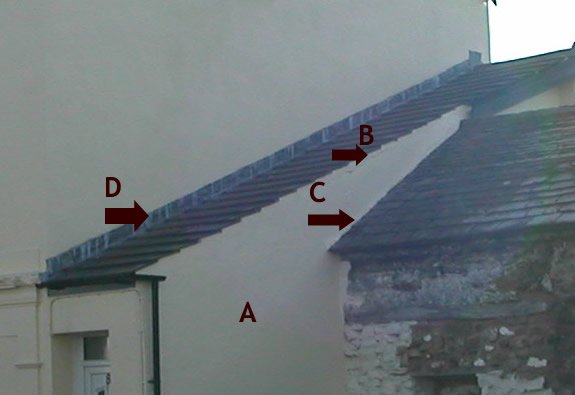

We have damp in the wall marked (A). A builder (friend) came and said we needed to get a roofer. The mortar below the tiles at position (B) (all the way down the line of tiles) was very damp and crumbly. Some of the rendering on that wall was cracked and blown too.

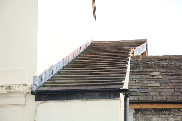

So the roofer came and said we needed a 4" overlap so he removed the tiles and relaid them with additional tiles to make a nice overlap. The builder then re-mortared and used sealant to make sure no water crept in between tile and mortar. The roofer also said that the flashing to the slate roof (C) was wrong and so replaced it. That flashing is now exposed so that it's flat against the wall and runs under the slates.
It doesn't seem to have sorted the problem out, but now I have a BIGGER problem.
After they left we started getting serious damp on the inside of the wall where the flashing (D) is (not just at point B but all the way down from the ridge). This flashing was replaced about 8 years ago by the previous owner who used a reputable local roofer. The current roofer came back looked at it, said it was all ok apart from a little bit of flashing they said was missing just the other side of the ridge. They did that. The problem does not seem to have been sorted though. Of course once you've got damp it can be difficult to know if the problem is solved or if it's the damp that was already there, so it's taken a while!
Anyway, we have other major damp problems in the house and are going to get another roofer to sort all the roofs. The first one who came (and this is where I'm looking for advice) - a reputable local roofer - said that the flashing at D is wrong and that as it is tiles instead of slates, the flashing should lay OVER the tiles and that this is probably causing the problems.
So I've got two roofers saying that it is is correct and one (who I'm more inclined to believe) who say it's wrong. Any thoughts?
