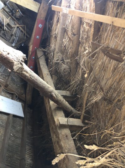

Any recommendations? Roof is thatched, thatch is near perfect unfortunately the structure holding it up is not and has to completely be replaced.

Are the roof timbers terminal? Seems such a shame because the Thatch looks in really good condition. Assuming it was replaced recently did the timbers not show signs of decay at the time?
