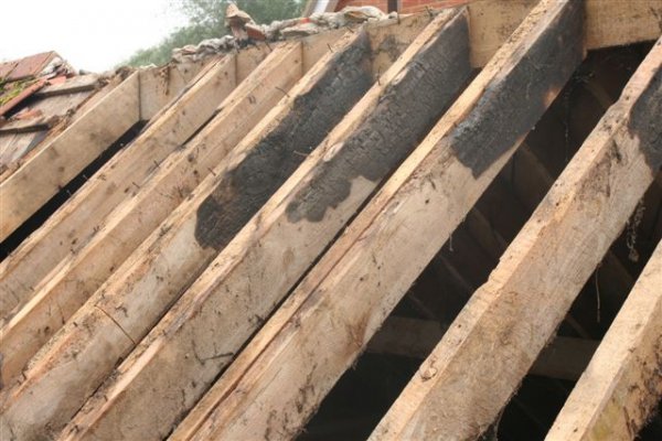

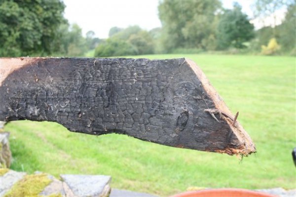

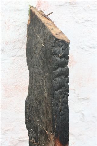

At first glance this will appear to be a daft question (indeed, it may turn out to be a daft question).
I'm repairing an outbuilding roof that's in poor condition and has been leaking in some places for quite a while and, unsurprisingly, has caused the roof timbers to decay in a few places. Not too difficult a job to actually brace/replace the affected timbers, but all the rigmarole of working on a roof.
Anyway, after stripping a section of pantiles, I've found that a number of the timbers look as if they've been in a fire - as per the pictures below - except this doesn't really make any sense because the charred look is very localised with adjacent rafters being unaffected. There is no burnt smell that I can detect.
So my question for the wood rot experts out there (Matt? :wink: ) is, could this damage have been caused by some form of wood rot following years of localised water ingress? I seem to recall photos of wood rot with a similar physical patterning, but nothing that has also turned the wood black.
Any ideas?
