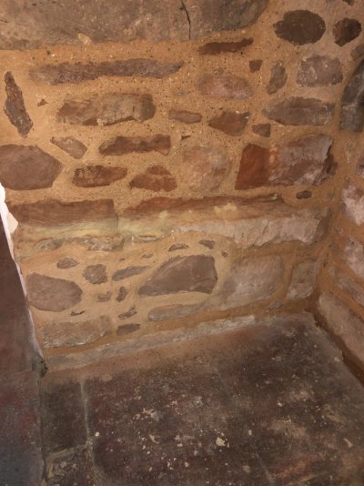

I have a huge beautiful inglenook in the living room. When I got the house I noticed some of the stones in the fireplace were rotting completely into dust, there was just a huge pile of dust on the hearth in the back corner.
The fireplace had essentially been slapped all over with cement trying to masquerade as actual pointing, so I had all that taken off, repointed in lime, and repaired areas where stones had rotted out too much to be salvageable.
The areas where stones had been replaced are now fine, but some of the older stone (I think it's called the quoins?) is still turning itself back into sand, so the lime obviously hasn't fixed it.
