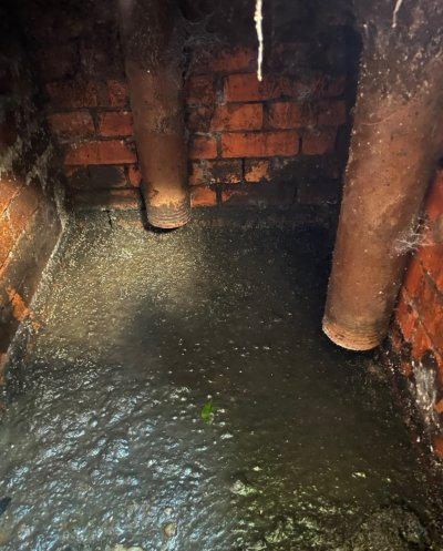

Hello, we are looking at purchasing a small two bedroomed cottage with a septic tank. Survey has been completed, and the age and condition of the septic tank was flagged up, along with a possible blockage somewhere between the house and tank. We’ve commissioned a survey, but in the meantime, I had a look at it myself. It was emptied around three to four months ago as it was smelling. We have never lived in a house with a septic tank before, so basing my limited knowledge on what I’ve gathered from the internet. My question is shouldn’t the two H pipes in the photo be half submerged? My understanding is one is an inlet and the other an outlet, but they and the bricks do not look like they been submerged in sometime. If there is a blockage that’s a lot of waste that’s going somewhere. Any thoughts would be welcome.
