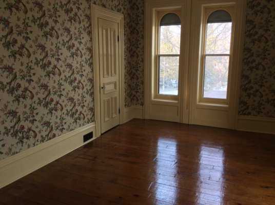

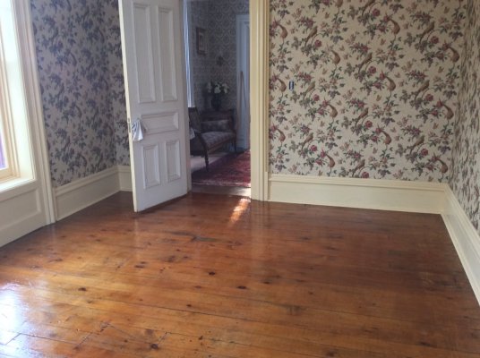

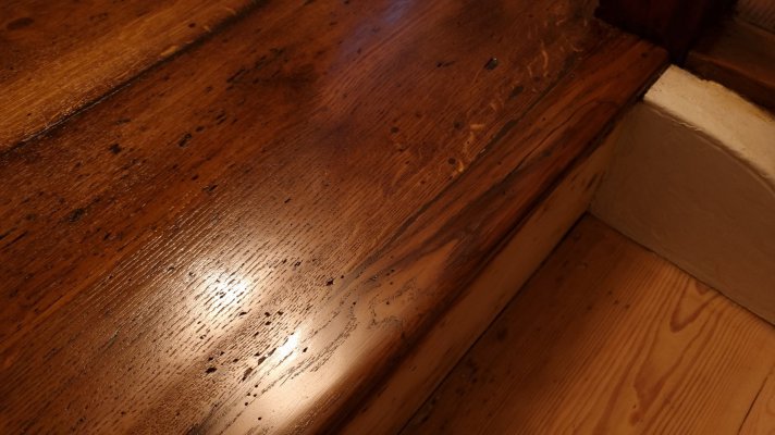

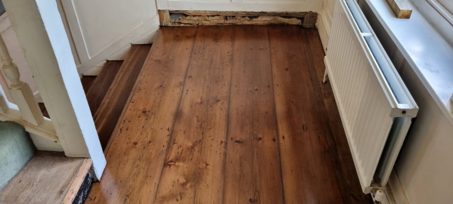

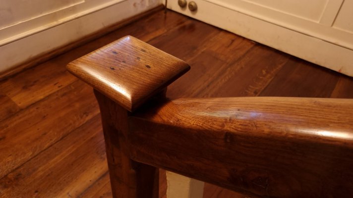

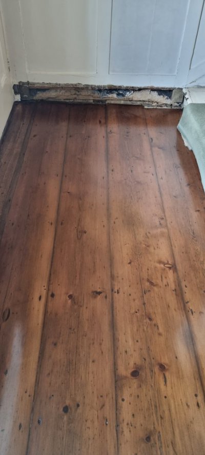

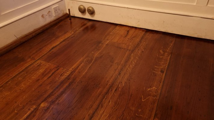

Not original shellac, it's been sanded very badly with a cheap drum sander, I can see the marks of what looks like an HT7 or similar. You would of been going over PU varnish probably, if it was waterbased it would of gone sticky. Floor would of been darker. If it originally had rugs and was original it would have a 2 to 3 foot dark brown-black ashphaltum border.View attachment 9171
The floors are fir. These pics are after re shellacking. The bark spots are history, some burn mark, others black ink nd yet others are just the knots. Thought it looked nice leaving all the patina. My suspicion is all our floors always had rugs.

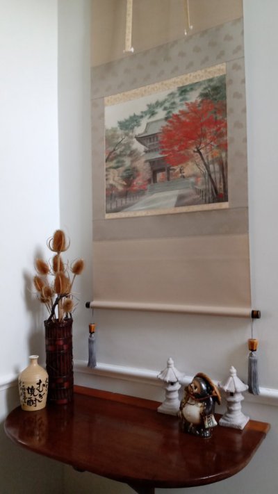

Feel free to post larger in focus photos.Lots of beautiful floors. Ours are mostly covered in rugs and we are "no shoes in the house" people ( after being in Asia outdoor shoes inside becomes a bit) so this is a tangential question..... Is it possible to spot refinish something which has been French polished?
The background to my question is that we have a mahogany? "Butler's table" on the landing, and our lovely tenants left a mark on it. It's like a bare patch of "not shiny" which is crescent shaped, possibly from the bottom of a vase or mug, but it's not a white mark. It's a small defect, and whilst I could have the whole table removed and sent for restoration I use the table and don't want it away and it's not so big that it's horribly noticeable, in fact often covered with my seasonal items.
Any wisdom gratefully received. Picture is my Autumn things on it, and doesn't show the damage, not helpful I realize
lol, fixing a rocket engine is easy for someone with the relevant knowledge and skills...Its a fairly easy repair for someone with the relevant knowledge and skills. If you have a good antiques restorer nearby its the kind of job he/she could do very quickly. That said a novice could ruin the piece all too quickly.

looks like PU varnish to me. Floors would have been left bare with a bituminous border. Occasionally some would wax the middle at some point. Unlikely to have been show wood unless Douglas Fir or Pitch pine.Toby, I should have been clearer in my “original shellac “ statement. I know the floors had been refinished, long before our ownership of the home, they were refinished a long time ago, at least that’s what I gleaned from the patina, So suspect early 60’s. That is when the owners we bought from purchased the home. They just recoated with shellac and much to my dismay painted all the woodwork white. May have been done earlier than that.
