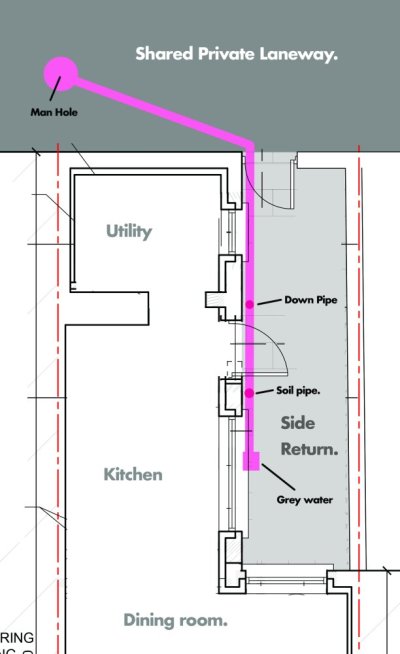

Hi everyone,
As part of the on going works at our victorian terrace I am removing a thick layer of concrete which was poured over the original paving tiles in the side return. It's roughly 75mm thick. It has bridged the original slate damp course and the air bricks.
Of course it's lead to damp and rotten joists all along the perimeter/kitchen wall! My aim is to get the suspended floor and this side return all back functioning properly.
Please see the drawing below. The existing waste/drain is in pink. This runs out to a shared private lane which is tarmac. (I need to dig this anyway to lay an electricity line out to our garage and garden beyond.)
I would really appreciate any advice or thoughts on the following points:
Thanks!
- While I'm at it I want to build a french drain along the external wall pretty much where the existing drainage line is. This is to help ensure no future problems with damp in these walls. Where should I position the new drainage pipe to accommodate the french drain? Bearing in mind this also is the soil pipe, kitchen grey water and rain water. Is running along the centre of the side return the best position? I will probably dig right back and make a new connection to the manhole.
- Due to lowering the external ground level I may need to install a step below the back door. Is this possible without causing a damp area below the door? If so whats the best approach to this with out interrupting the french drain?
- I'm very comfortable with carpentry, roofing and brick work but ground works is newer to me so is there anything else I need to consider here?
Thanks!
