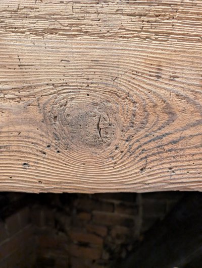

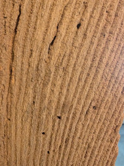

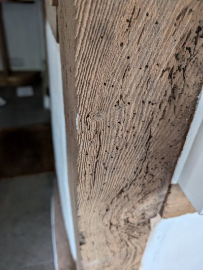

3. It is not definitely NOT gentle and it HAS damaged my beams, leaving the solid ceiling beams with the texture of felt. The more fragile wall beams now look like driftwood. In other places there's a rippled effect because they blasted away the sapwood.
4. They told me my beams would not need any further treatment but I now need to pay someone to try and fix the damage.
