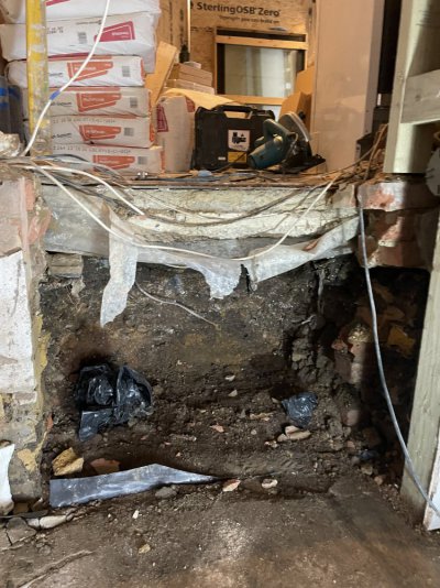

We recently discovered that ground floor living room of our Victorian terrace house is a concrete slab, under which is a layer of DPM, then sand, then soil. When we opened it up, we were expecting to find a suspended timber floor, with a void providing ventillation (this is what the neighbours in our terrace have), but think this was done around 1980 for some reason. We suspect that this is causing persistent damp in the surrounding walls. We are planning to treat this with 1 metre of sand cement on most of the walls in the living room. The extension we're building at the back is at a lower level (about 3 steps down), and those walls are also affected (we discovered this while digging into the wall to build the steps). Does anyone have experience with this? Is it common practise to fill in a void, and or is it something we should be worried about? We don't have the budget to pull up the entire floor and excavate, but want to minimise problems with damp. Thank you!
