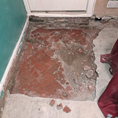

We are laying a new breathable floor in our kitchen, after following lots of advice from this forum. We have some questions about this process. Pictures currently of what the floor looks like at the moment.

Property Details
3 Bed Victorian mid-terraced house. Solid build (no cavity). Built approx. late 1890s.
Solid Floor in kitchen – previously original Ruabon quarry tiles laid on dirt.
Ruabon quarry tiles as a concrete screed had been laid over them – sending damp into the edges, into the skirting board and walls.
Now removing concrete and original tiles and re-laying a new floor back onto dirt. We will ensure good ventilation in this area too.
Kitchen Area: 18.6 Sq M (approx)
N.B. I know that a limecrete floor, dug to around 25cm with a glass aggregate underneath is a warmer and more breathable option, but the cost of around £200-£250 per square meter (total around £4000) is slightly too prohibitive for us.
