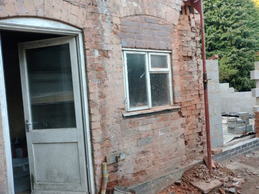

Apologies have not been active on the forum as lost in the work at the moment. Situation to date:
Rear single storey cavity extension will be attached to traditional solid wall Victorian (9 inch thick non cavity wall building) off course Victorian wall has lime mortar, top part of wall OK bottom part not OK.
Height of facing bricks of extension approx 2.7m to eaves level as measured from DPC.
Most of the bricks of the adjoining wall old solid wall is in poor state , luckily only the bottom section of the wall (the facing single layer of bricks- some spalled, some with paints etc) which run continously with the extension wall .
These spalled facing bricks are between the engineers and the 2.7 m height as measured from the engineers.
I am planning to take a section of old wall out BUT only the outer leaf external bricks due to above reasons. The internal leaf of old wall stays as is.
So section of old wall about 3.2 m length and 2.7m height to be removed, getting acro and strong bouys put in today, I m going to remove bricks today and hopefully brickie will start work by tomorrow on this section or latest by Monday.
Question:
1) Do I use Non Hydraulic Lime/Lime putty or NHL 3.5 as mortar joints for the outer leaf Victorian solid wall replacement?
2) With NHL will I need to get sharp sand and yellow building sand ? - already have yellow sand, thinking of ordering1 tonne of sharp sand if its required. IS that sufficient?
3) How about Non Hydraulic Lime/Lime putty do I need any other ingredients to make mortar mix up e.g sharp sand, plastering sand etc
4) Does plastering sand come into the mix as well for making lime mortar or will sharp sand be sufficient?
Thank you in advance , off to the site as gettting acro set up and removing old bricks
I'm based in Birmingham. Can get NHL 3.5 and the sands easily from local merchants. So EHS Smith or Tippers. Both supply Heidelberg NHL 3.5
https://www.ehsmith.co.uk/heidelberg-materials-25kg-natural-hydraulic-lime-white-3-5-00060406

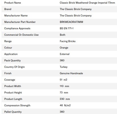

Done calcs will need about 20 bags I think for 10mm mortar joints for 73mm height facing bricks for the replacement area 3.2m by 2.7m
Please correct me if I'm wrong with calcs or any other info
Many thanks
