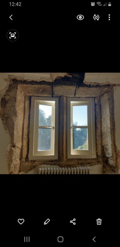

Now removed cement render from the 6th window. The sandstone underneath is crumbly to say the least, this is by far the best condition one we've uncovered. Any advice on anything that can be added to the stone to try 'solidify it'? All have / will be allowed to dry out and lime pointed however the earlier completed ones are still very fragile.
All are double chamfered with cavetto moulding to the mullion for the geeks like me
Although the cavetto is more straight shaped after years of determination under the 'c' stuff.
