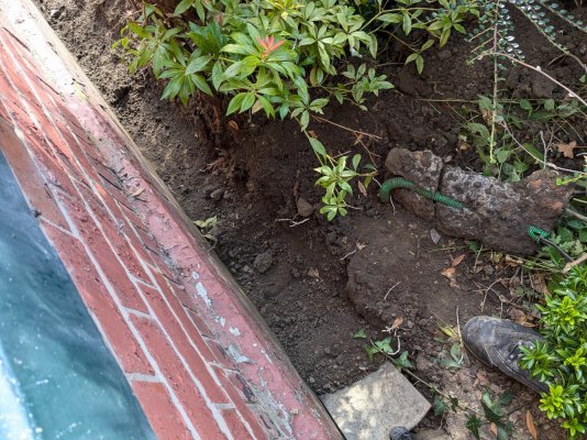

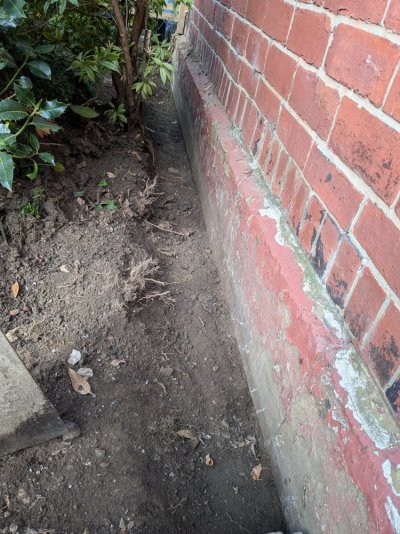

Hello PPUKers,
Shown in the photos below is the stonework along the front of our ~1890s Victorian terrace. Yes, a boring byelaw building; sadly not a 16thC stonework cottage! :-D

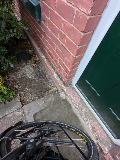

The photo featuring the front door shows how the front step is in rather poor shape, and its shabbiness is what got me investigating by cutting the shrubs right back away along the wall.
All along the paint has reached the end of its life and is peeling off, revealing spalling to the surface of the stone (stone comes away with the paint in some places...)
This morning I've dug away the soil to reveal the bottom of the stone (and a peek of the brick course beneath). I'm hoping this will let the stone dry a bit and maybe even reduce humidity in the cellar.
My question to you experts is: what should I do now?
Possible tasks:
Any and all advice and anecdotal experience greatly appreciated! Thanks all.
Possible tasks:
- Wire brush off all the peeling paint seems like the first step, or is this too harsh on the stone?
- Leave the stone exposed with the little trench present
- ...or return the soil to its original level?
- ...or return the soil to a level which covers the under-bricks but not the stone?
- Paint the stone with a stabilising primer and then masonry paint
- ...or leave it au naturel too see how the weather treats it?
