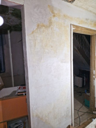

This is an internal wall, it is weird as it has appeared in some places and not in others.Its an internal wall so unlikely to be due to damp?
that colour looks like the distemper some of my walls were originally coated with
Solid brick and lime, originally.What's the wall built with?
I assume you lime skimmed these walls over the original lime? I'm wondering if the acidity of the lime has raised a previous finish that wasn't visible. Like I said, that yellow looks very familiar.Solid brick and lime, originally.
Pedant patrol.I assume you lime skimmed these walls over the original lime? I'm wondering if the acidity of the lime has raised a previous finish that wasn't visible. Like I said, that yellow looks very familiar.
Did you float the skim flat at all before polishing, sometimes that can have the effect of reviving whats underneath.
Yes it is a very thin lime skim that we did, apart from the areas that the old lime was removed and patched which coincidentally or not don't seem to feature any stains. What ever this is it definitely came back from the dead because of the new skim coat.I assume you lime skimmed these walls over the original lime? I'm wondering if the acidity of the lime has raised a previous finish that wasn't visible. Like I said, that yellow looks very familiar.
Yes, you're right, salts is perhaps the most likely explanation.Pedant patrol.
It is perfectly probable that the stains are precipitated salt solutes that were leached from the underlying substrate.
Lime is indeed caustic, thus reactive.
It is also famously very un acidic.
As in very heavily alkaline. Around pH12 when wet.
