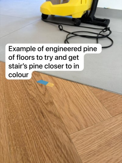

Now, we want to give the stairs a bit more colour (to closer match the engineered oak floors we have on the different floors of the house), and properly finish them.

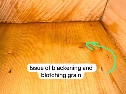

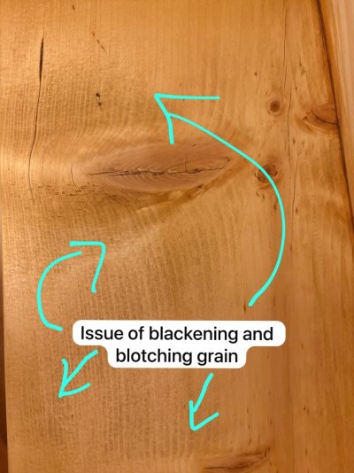

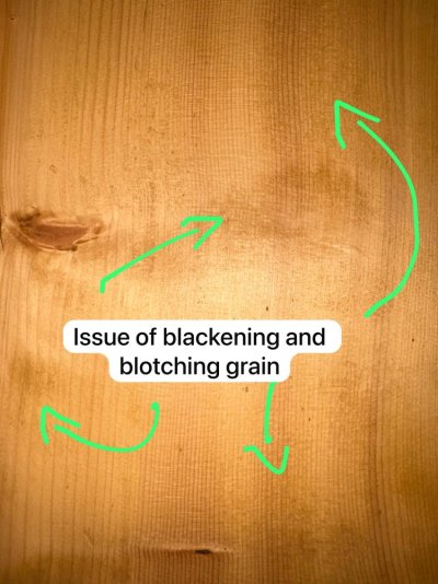

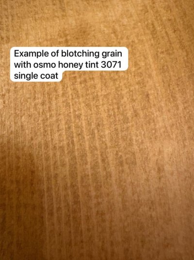

I had been recommended OSMO hardwax finishes, and was working towards using the Osmo honey tint (3071), followed by the semi-matt clear coat (3032). After testing a single coat of honey tint on a couple of steps (after testing on some wood), it came out poorly - blotchy on some grain parts, darkening to near black some places. Customer service told me it might be because I used white spirit to clean the stairs rather than methylated spirits, leaving some resedue... and possibly because I wiped of excess.
I've attached photos of the sanded stairs and some of the stained steps.
