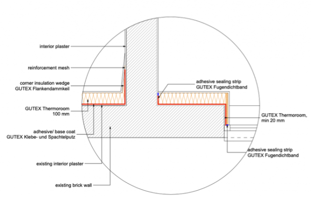

Anyway, the wall insulation details seem thorough, though I am unsure if they are the best way to add insulation to lime plastered walls.
This other drawing alongside the above makes no sense to me.
