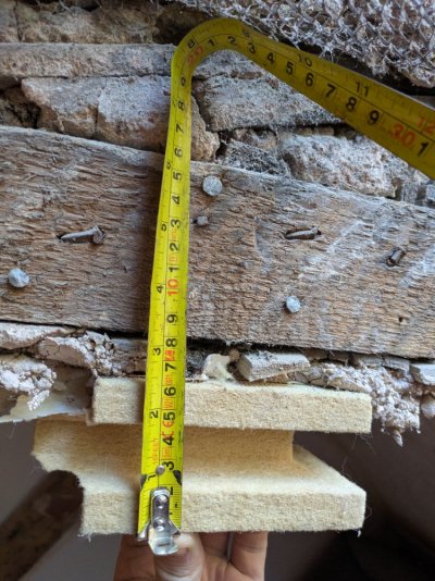

I'll use some mechanical fixings through to the roof joists where possible too. Based on the photo below, should I use 120mm or 140mm fixings?

The photo below shows a handy cross section.
