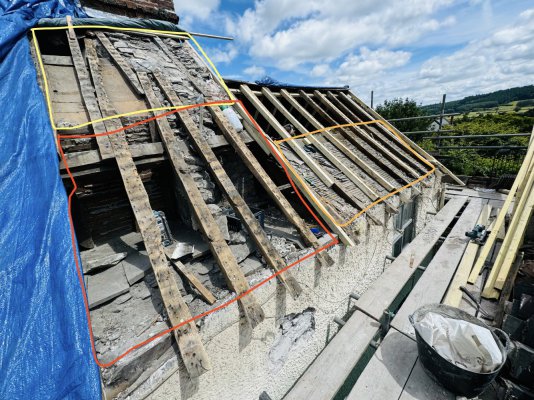

I'm hoping for some help re. insulation on a roof that is currently open!
The basic plan is TLX Gold draped over the rafters.
But I'm wondering about whether to add some Steicoflex between the rafters in the orange box. Is this sensible? And if so, would I have to make sure there is an air gap?
I plan to insulate the yellow box from the inside, with wood fibre board and maybe some Steicoflex between the rafters.
I'm unsure what to do in the red box... a very disordered space. My default will probably be some Steicoflex against the lath and plaster with Cosywool laid out along the bottom.
Any help would be appreciated!
