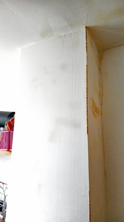

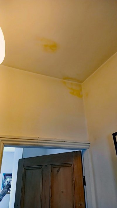

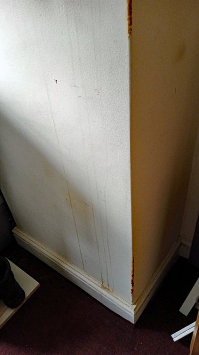

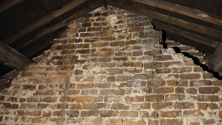

Hello I'm new to this Forum. My house is a stone end terrace, 1890, in Derbyshire. I would like advice on the type of base flashing as a roofer has suggested that after fitting soakers and, I assume , step flashing, he would cover the whole of the flashing with mortar from the roofline to the underside of the stone skirt.
The reason I have contacted a roofer is because when there is a period of heavy wind and rain water will enter the rear chimney and drip onto the fireboard above the fireplace. The rear chimney pot was removed at least 15 years ago and the top was capped. I have a wood burner in the fireplace of the front room and as far as I can tell there is no water ingress.
The roofer also opined that the mid-feather brickwork could be damaged and is allowing water to pass into the rear flue via the chimney pot.
The attached photo shows the area beneath the stone skirt, if that is the correct term. I would welcome any advice on whether covering the base flashing is good practice or not as I have read that the mortar can prevent the necessary movement of the flashing during thermal expansion and contraction, leading to cracking and leaks.
