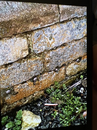

Thanks for your response Stevers. Surveyor is due out mid-January, the property does smell damp, but not much evidence of this at base level inside.Looks like the plugged holes for a patent damp proof injection system. Whether that's good or not is down to whether it worked, but it's fair to say that there's considerable sceptism about the process amongst forum members.
Just because you can smell damp doesn't mean your walls are damp, in fact I would say that would be the most unlikely culprit whether the walls are damp or not. The smell would most likely be coming from the floor - underlays, laminate, carpets. One of the first things to check on your new journey is the construction of the floor and whether there's good airflow (suspended floor construction)Thanks for your response Stevers. Surveyor is due out mid-January, the property does smell damp, but not much evidence of this at base level inside.

From the small amount you’ve disclosed, the building will certainly be damp and smelly! - sources will vary though. No ventilation, no heating aren’t great. Get in, open up windows, get chimneys functioning as designed, put some heat into the old girl and start taking stock after all that has time to take affect.Thanks for your response Stevers. Surveyor is due out mid-January, the property does smell damp, but not much evidence of this at base level inside.
