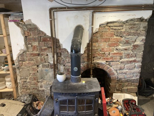

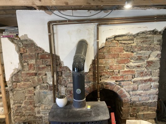

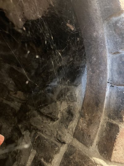

Ok, I’ve been hacking off yet more thick cement render, and started exposing this large chimney breast / fireplace and this is what I’m working with. It’s a proper mess.

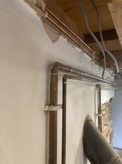

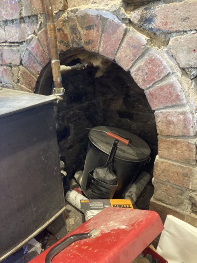

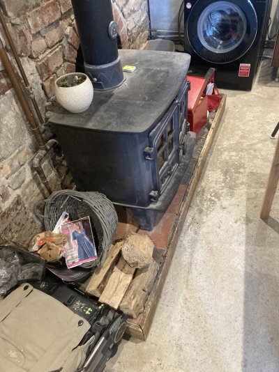

As you might be able to tell, it’s built with a mixture of red brick and stone (on the edges). There are 2 openings, the brick arch on the right which seems to be pointed in cement and has a strange iron reinforcing strap on the underside (I'm wondering if this was rebuilt at some point in the relatively recent past), and some kind of bricked up oven thing (bread oven?) on the left. There is a dinky little “shoulder” on the left side of the structure. The hearth where the woodburner is currently sitting is in a terrible state (random, non-matching and loose and cracked tiles, broken cement pointing between them, etc.) and it sticks way out into the room which ruins a lot of the room’s floor space. Lastly, there’s a structural joist timber sitting above the masonry with rad-pipes attached at a level LOWER than our final inter-joist ceiling board height.
Assuming no restrictions on anything, how would YOU holistically clean up this mess and make it attractive and functional again?
