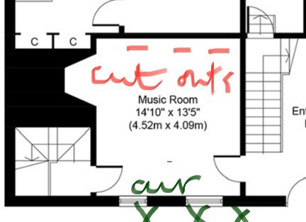

Hi,
Newbie here wrestling a 1760s house into a cosier home. Very grateful for wisdom offered.
Most of the house has agricultural strength (!) concrete floors and, in places, slathered over very soft red bricks walls too.

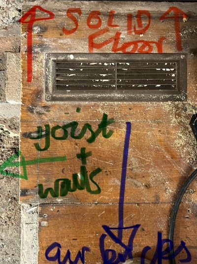

However one front room about 4m x 4m has suspended timber floor on sleeper walls over earth with 3 air bricks vents to the outside. Probable that the sleeper walls (painted with bitumen) were added along with new joists and floorboards sometime mid-C20th - about 300mm above earth.

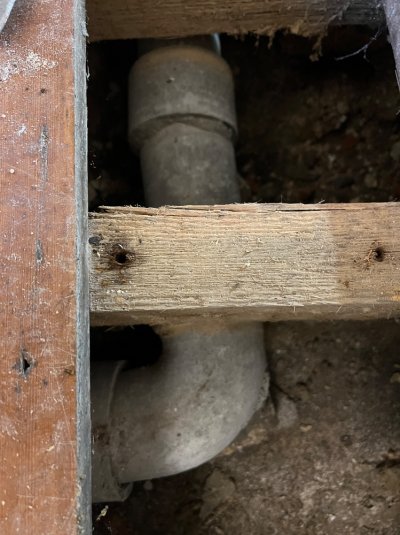

There is some rot in joists adjacent to the walls where internal concrete patching render and gypsum inhibit airflow & breathability. Air bricks now free from debris and clear to external.
Remedies??
Thank you from me & the toad we found under the floor!
Remedies??
- Free up any sleeper walls that have earth debris above bitumen layer
- Chop out rotten joists and replace or sister where conditions suggest
- Gypsum to be removed at low levels from walls
- Look into insulating
