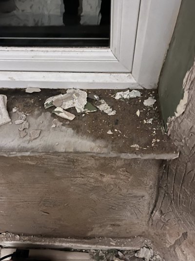

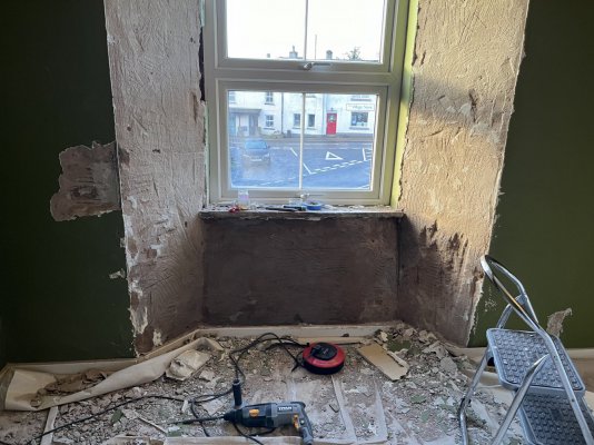

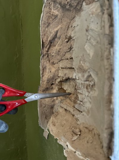

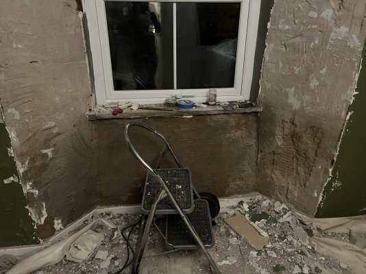

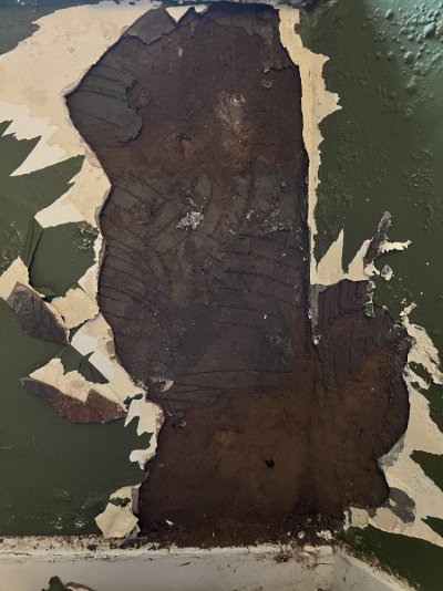

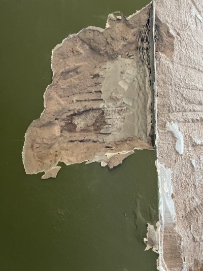

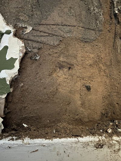

I’m just dreaming and it’s gypsum, right? I’ve never removed plaster before. This is dark brown, sandy and crumbly. It’s damp too. It appears to have a scratch coat. Where I dug in deeper, it became drier the deeper I went. It changes colour and is not damp higher up the wall.

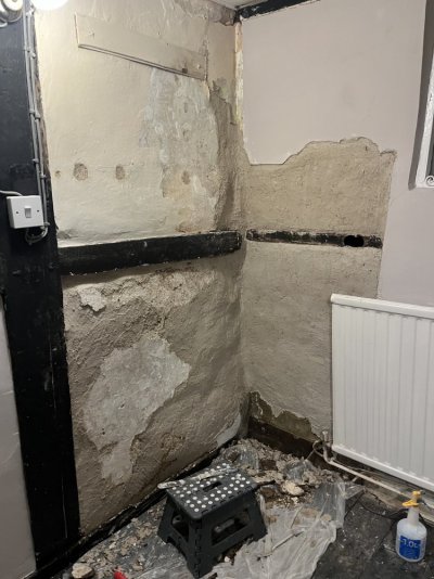

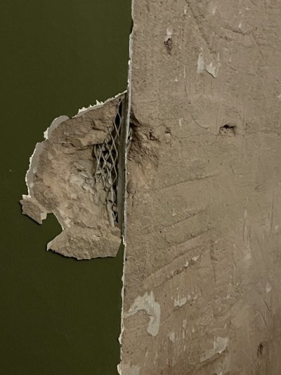

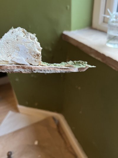

The layers above it come off as a unit and are paint, paint, pink (gypsum), grey and solid (cement?) then this layer.
Many thanks for any insights!

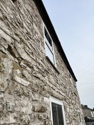

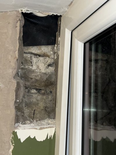

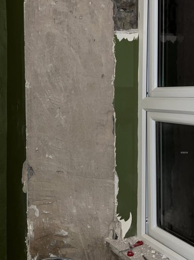

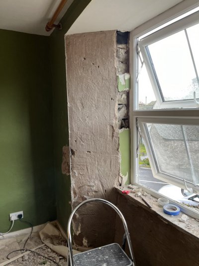

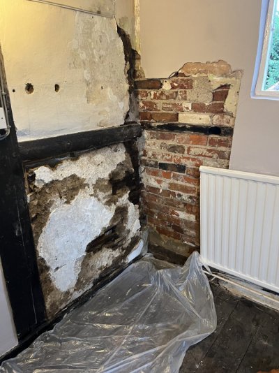

 just need to identify and remedy the sources of ingress now
 just need to identify and remedy the sources of ingress now  based on what I can see on the photos I’d look at the detailing at the bottom of the window
 based on what I can see on the photos I’d look at the detailing at the bottom of the window And you know, there are surprisingly few photos online that show what a breathable wall looks like when it's damp.
