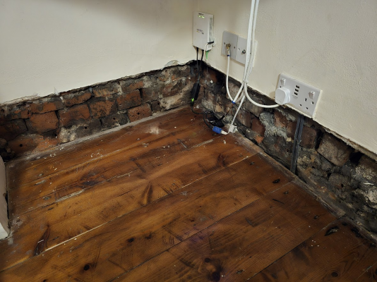

I have an end of terraced 1900ish house, and the pictured wall is the end of the terrace.

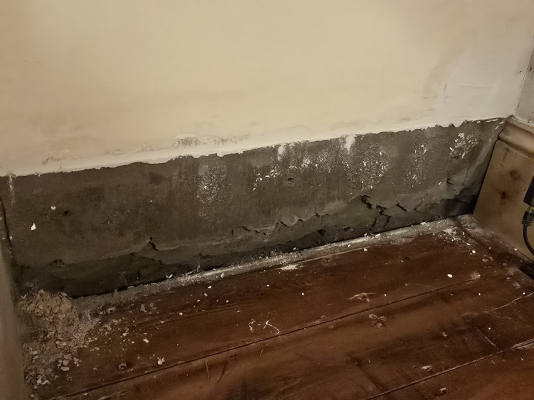

For a long time, the corner by the various aerial sockets showed a triangular damp patch soon after it rained (second photo below). It was quite constrained to just that corner though, both visually and with a damp-meter. It would sometime vanish entirely in dry weather, then be very obvious after downpours.
After some investigation between me and a builder, we found a few deep un-pointed holes in the external mortar near that hole that had been hidden behind bits of garden - and a test with a hose pipe on the external wall showed water dribbling into the corner.
These joints were all repointed, the damp area of plaster hacked off and patched with sand/cement then a skim of filler (visible as a darker triangle in the top photo below)
At the same time the space behind the old skirting was given a coat of sand/cement with a bostik water impervious additive (I don't have a photo of this), and the skirting boards replaced

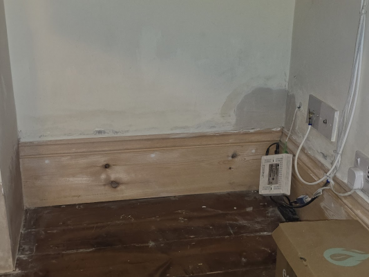

This was all done ~7 days ago. Confusingly (to me and him), there is now a faint tide mark to the left hand side, running parallel to, and a couple of inches above, the new skirting board, that has never been there before.
Initially I thought is was just dirt - but it survived a clean, vanishes with a fan heater, then reappears a day later. When present, it drives a damp meter crazy (and likewise when dried out, readings return to normal)
Any thoughts as to what this could be? Trying to be methodical, the only obvious new thing to the left hand side of the image is the sand/cement below the skirting. The builder is very confident this isn't the problem, as it is quite thin and he used a "bostik integral waterproofer".
Of possible relevance, that wall is below ground to about the height of the top of the skirting board on the left hand wall. The wall to the right has ground level at floorboard level. However, this is a constant - and has been the case since well before this recent work (possibly since forever....)
