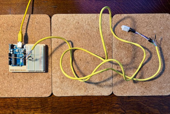

I built a little setup that lets me monitor the temperature and humidity at the end of long Ethernet cables. I used DHT22 sensors plus and Arduino Uno for readout.
I’m thinking to fix these sensors and cables in a couple places in air gaps inside my timber frame before it’s rendered over.
My thought is to monitor the humidity as the timbers dry out completely and catch any increases in humidity arising from unanticipated water ingress.
However, I’m wondering whether I will be able to collect any actionable information, given that air humidity is not the same as wood humidity. What kind of humidities would be healthy in enclosed environments like this?
Has anyone else tried something similar?
I’ve also considered making a proper wood humidity sensor, which doesn’t seem that difficult. But with this I would only be making measurements of individual bits of wood rather than sampling the general environment.
