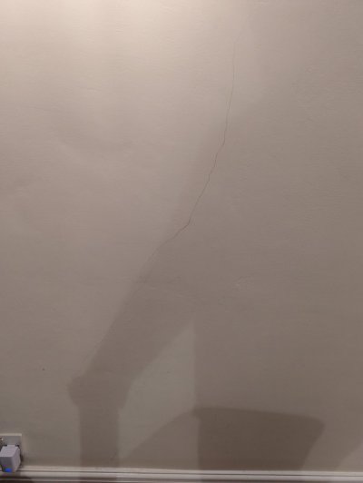

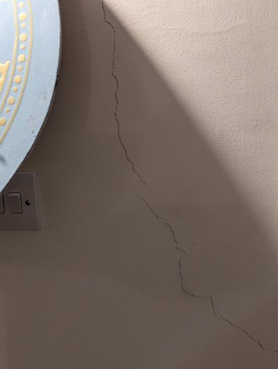

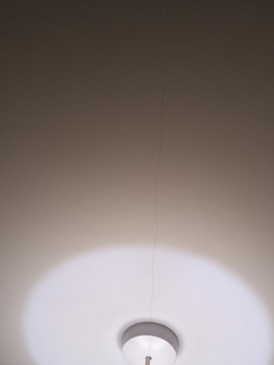

Now to get to the point. We have hairline cracks appearing everywhere. There was one or two here and there when we first moved in which were identified as being movement of the frame but now there are long cracks of some sort on every wall and ceiling in the old cottage, some of which run the entire length of the room. Again these are thin - no more than 1mm.width but there are so many of them it's causing us some concern. It seems that they have sprang up in a matter of a month or two.
Does anyone have any thoughts on this. If it is genuinely movement of the frame then that is one thing but given that these have sprang up in such a short time my concern is that there is some sort of structural failure at play.
